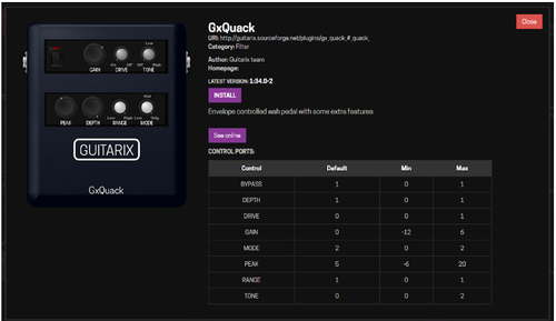

| + | # <li value="3"> Click on the plugin that you wish to install (in our case, the "GxQuack"), and the following screen will show up: | ||
| + | [[File:Gui-14.png|500px]] | ||
| + | # <li value="4"> On the plugin screen, click on the[[File:PluginStore InstallButton MODWebGUI.png|60px]] button | ||

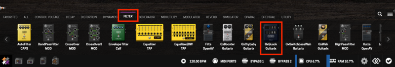

| + | # After installation, the plugin will be added to the Plugins Bar. You can find it either in the "All" tab or the one corresponding to the plugin category (in our example, "GxQuack" is categorized as a "Filter" plugin. | ||
| + | [[File:GxQuack PluginsBar.png|800px]] | ||

Let's take, as an example for this guide, the "GxQuack"
- Open the Store from the Web GUI
- Browse available plugins or use the search bar in the bottom left corner of the Plugin Store screen
In our example, we will use the search bar and type "GxQuack"
- Click on the plugin that you wish to install (in our case, the "GxQuack"), and the following screen will show up:
- On the plugin screen, click on the
button - After installation, the plugin will be added to the Plugins Bar. You can find it either in the "All" tab or the one corresponding to the plugin category (in our example, "GxQuack" is categorized as a "Filter" plugin.
