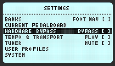

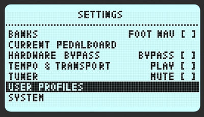

Accessing and navigating the Settings Menu
Press and hold the left endless knob to open the Settings Menu.
On the left screen, you will see the main menu. The right screen will display the sub-menu related to the current item selected on the main menu.
Scroll the options in the main menu by rotating the left knob. Some options have a toggle indicator that can be triggered by quick-pressing the left knob. These options have a "[ ]" or "[x]" indicating the state of the toggle. For example, the Hardware Bypass can be turned on or off by pressing the left knob.
Scroll the sub-options using the right knob. Quick press the right knob to access a third level menu or to just turn on and off the selected option.
Press and hold the left knob again to exit the Settings Menu.

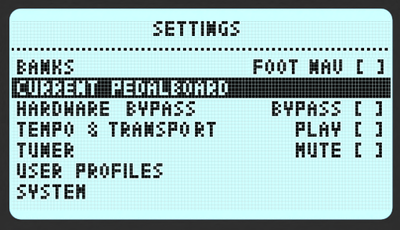

Current Pedalboard
This option allows you to restore the default state of the pedalboard, or to override it with the current state.
Selecting the "Reset state" option on the right screen will discard any changes you might have made to any parameter of any plugin and restore the state of the pedalboard as it was the last time it was saved.
Selecting the "Save state" option on the right screen will save the current state of all parameters of all plugins. Next time you load the pedalboard or choose the "Reset state" option, the pedalboard will go back to this state.
Note: You can only access these setting when you are disconnected from your computer.

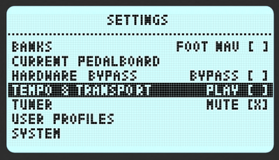

Tempo & Transport
With the 'Tempo & Transport' menu selected push the left endless knob to activate or deactivate the transport. In other works, this works as if you were pressing play on your DAW.
On the right screen you can see and edit both the tempo (in bpm) and the time signature (beats per bar). The count is always done in quarter notes.
To edit both the 'Tempo' and the 'Beats per bar' simply select them, push the right endless knob and turn it.

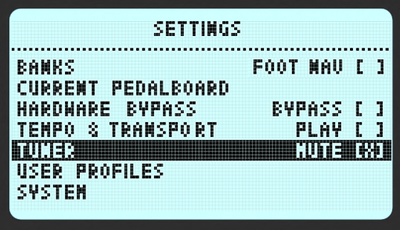

Tuner
On the MOD Duo you can quickly access the Tuner by pressing and holding the right endless knob any time. Press and hold it again to exit.
This option allows you to tune your instrument. Both inputs can be used as the tuner input, to select between them short press the right endless knob.
If you see a question mark on the tuner screen, it means the device is not receiving any input or the input levels are too low.
Choosing whether the tuner should mute the outputs when activated:
In the settings menu there is an indicator "Mute [x]" that you can toggle to mute your outputs or not when tuning. Short press the left knob to change this value.

On the left screen, navigate to the "User Profiles" menu. On the right screen, the 4 User profiles (A, B, C, and D) will be displayed. The current selected user profile will be marked with a checkbox "[x]".
With the right knob, navigate through the profiles and short press the knob to select the profile you want. Confirm the change.

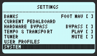

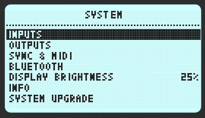

System
Below this menu you have the following options:
  • Inputs
  • Outputs
  • Sync & MIDI
  • Bluetooth
  • Display Brightness
  • Info
  • System Upgrade

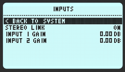

Inputs
This menu allows you to control Input gains.
Stereo Link: If ON, input gains for both channels will be linked and changes applied to one channel will also be applied to the other one.
Input 1 and Input 2 Gain: Navigate to one of these options and press the right knob to select which one you want to change. Turn the knob to change the value and press it again to exit edit mode.

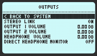

Outputs
This menu allows you to control Output volumes.
Stereo Link: If ON, the output volumes for both channels will be linked and changes applied to one channel will also be applied to the other one.
Output 1, Output 2, and Headphone Volume: Navigate to one of these options and press the right knob to select which one you want to change. Turn the knob to change the value and press it again to exit edit mode.
Direct Headphone Monitor: Allows you to turn on/off a direct monitoring of the incoming audio (via inputs) on your Headphones output.

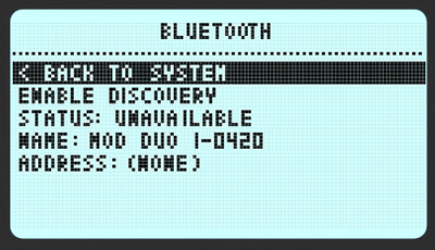

Bluetooth
This option displays your Bluetooth status information and allows you to turn on the Discovery mode for 2 minutes. For more details of using Bluetooth with MOD devices, see the full Bluetooth article here.
Enable Discovery: Select the option to turn on the Bluetooth discovery mode. After confirmation, your device will be visible for two minutes.
Status: Shows if the discovery of your device is available or not.
Name: Shows the name of your device in the Bluetooth network. You can change this name on MOD Web GUI. More info here.
Address: Shows the Bluetooth address of your device.

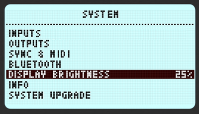

Display Brightness
Scroll with the right knob until you have the "Display Brightness" option selected, then press the endless knob and change the LCD's brightness. Each click will change between the available options:
  • 0% (off)
  • 25%
  • 50%
  • 75%
  • 100%
You should adjust this value accordingly to your environment and to your viewing angle. Flat viewing angles may require higher brightness settings and vice versa.
