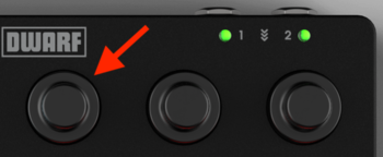

Endless knobs
The endless knob click / hold down and turn modifies interaction with the knob function.
For example:
- on some parameters, you can push the endless knobs to access a full-screen view of the parameter and/or lists;
- In navigation mode, you can click the knob to load the pedalboard, etc.
On each of the knobs, you can have different parameter types:
- Knob: turn for precise value change, hold pressed and turn for coarse value change;
- Trigger: turn left, turn right or click to trigger;
- Toggle: turn left for off, turn right for on, or click to toggle;
- List: turn left to open the list and select prev item, turn right to open the list and select next item, click to open/close overlay, hold pressed then turn then release to open the list, then change the value, then immediately close the list.

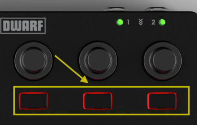

The MOD Dwarf push buttons (the three rectangular push buttons under the three knobs) can be used to:
- switch between sub-pages of assignments for the encoders in Control Mode
- Perform actions visible on the screen in Navigation Mode, device menu, or in the device settings menu.

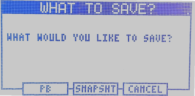

It allows you to access a quick menu for the MOD Dwarf. From there, you can save pedalboards or snapshots, access the device settings, or quickly change three items of your choice.

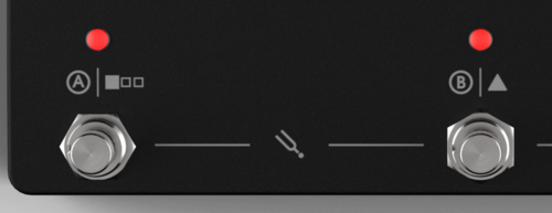

The MOD Dwarf has three footswitches allowing you to use your feet to quickly access and change parameters. Ideal for guitar or bass players and/or those who perform with the MOD Dwarf on the floor.

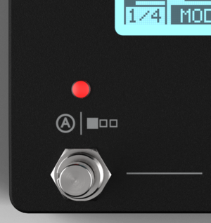

Footswitch A
The footswitch A assumes different functions according to the active mode:
- cycles between pages in Control Mode
- cycles between views in Navigation Mode (pedalboard or snapshots list)
- cycles between tools in Tool Mode
When pressed simultaneously with the footswitch B, the footswitch A is also used to access the Tool Mode.
Note that the footswitch A is not available to assign a plugin parameter in Control Mode, just like the footswitches B and C.

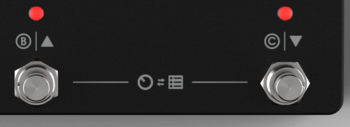

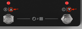

Footswitches B & C
The footswitches B and C take on different functions according to the mode active on your MOD Dwarf:
- In Control Mode, the footswitches are used to control parameters from your pedalboard. Those parameters are mapped by the pedalboard creator. Each footswitch can control up to eight different parameters thanks to the pagination system.
- Still in Control Mode, the footswitches can be mapped together to cycle up (footswitch B) or down (footswitch C) on list-based parameters (like plugin presets, file loaders, plugin modes, or algorithm types)
- While in Navigation Mode, the footswitch B will cycle up and the footswitch C will cycle down on your active list (either pedalboards or snapshots)
- In Tool Mode, the footswitches assume functions preassigned (and shown on the screen) according to the tool.
When pressed simultaneously, the footswitches B and C allow you to access the Navigation Mode.

To cycle between the main assignment pages, you can use footswitch A.
- Push the footswitch to cycle forward
- Long-press to cycle backwards
The three push buttons under the endless knobs provide access to the 3 encoder subpages for the active main page.

In Navigation Mode, you push Footswitch B to move up on the list and Footswitch C to move down.
If you use the footswitches to navigate the list, you will automatically load the pedalboard or snapshot (according to the type of list that you have active) that you scroll into.

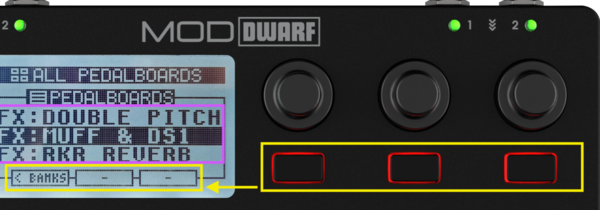

In Navigation Mode, you can also access the list of pedalboard Banks available on your device.
For that, you should:
- Open the Pedalboards view from the Navigation Mode (check here how to switch between the pedalboards and snapshots lists);
- Push the left-most button of the MOD Dwarf, that corresponds to "< BANKS" on the MOD Dwarf screen
To navigate the Banks window on your MOD Dwarf, you should use the left-most encoder.
A right-pointing triangle before the entry name will indicate your current active Bank.
Turning the encoder clockwise scrolls down the list, and counter-clockwise scrolls up the list.

- Push the central button, corresponding to "NEW" on the MOD Dwarf screen
- Input the name of your Bank (learn how the text input screen works here)
- Push "Save" (left-most button) when you are done
- If you wish to rewrite the name, push "Clear" (central button)
- If you want to cancel the Bank creation, press "Cancel" (right-most button)

- use the left-most encoder to scroll to the first pedalboard on the Bank list
- Turn the encoder again to the left to highlight the option "ADD PB TO BANK"
- Push the encoder
- You will now see the Banks screen again, where you need to access the Bank where the pedalboard you wish to add is already stored
- Use the left-most encoder to scroll the Banks and push it, or push the left-most button (corresponding to "ENTER") to enter a Bank
- Once you find the pedalboard you want to add, scroll to highlight it and push the "SELECT" button (central button) or the left-most encoder

To select which input to use for the Tuner, push the footswitch C (right-most footswitch). You will see the representation of the button on the screen changing between "INPUT 1" and "INPUT 2".
Activate or deactivate tuner mute function
You can define if the tuner mutes your output while in use or not.
For that, push the footswitch B (central footswitch) on the MOD Dwarf. When active, the representation of the Mute button on your MOD Dwarfs screen will appear fully dark with light letters, as follows:

- Access the device's Menu
- There, on the bottom of the screen, you will see a button named "Save" associated with the left-most push button.
- Push that button and you will be forwarded to a screen asking you what you would like to save, if a pedaboard or a Snapshot.
- Use the push button on the MOD Dwarf correspondent to your wish.
- PB for pedalboard
- SNAPSHT for snapshot
Use the button "Cancel" (right-most push button that lights up in red) to abort the process.

- Push the Footswitch A to access the Snapshots list for your loaded pedalboard (if not yet on the Snapshots page)
