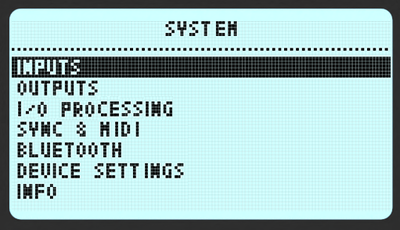

System
Below this menu you have the following options:
  • Inputs
  • Outputs
  • I/O Processing
  • Sync & MIDI
  • Bluetooth
  • Device Settings
  • Info
  • System Upgrade

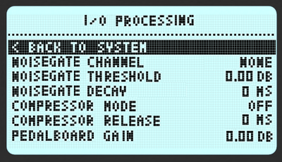

I/O Processing
On this menu, you can activate and set up some input and output processing settings on a device basis.
These settings are independent of your pedalboards and, when active, will be applied on top of your pedalboard effects chain.
You have the following settings available:
Noisegate Channel: allows you to activate a noise gate either right after the input 1, the input 2 or both. By selecting "none", the noisegate will remain deactivated.
Noisegate Threshold: allows you to define the threshold level (in dB) of your input noisegate.
Noisegate Decay: allows you to define the decay level (in milliseconds) of your input noisegate.
Compressor Mode: here you can activate a compressor right before the output of your MOD Duo X. For this compressor, you have 4 different modes: Off, Light, Mild and Heavy.
  • Off: the compressor will remain deactivated
  • Light: there will be a light compression applied to the output
  • Mild: there will be a mild compression applied to the output
  • Heavy: there will be a heavy compression applied to the output
Compressor Release: allows you to define the release level (in milliseconds) of your input compressor.
Pedalboard Gain: here you can select a general gain level applied to all your pedalboards. That's a different type of gain than the output gain of your MOD Duo X

Status: Shows if the discovery of your device is available or not.
Name: Shows the name of your device in the Bluetooth network. You can change this name on MOD Web GUI. More info here.
Address: Shows the Bluetooth address of your device.
Device Settings
USB-B Mode
Allows you to define the behaviour of the USB-B port of your MOD Duo X.
  • Network (Default): The port works as a network device, so you can access the WebGUI.
  • Net+MIDI: The port works as a network device, so you can access the WebGUI. Simultaneously, the device sends MIDI messages via this port and therefore, is also recognized as a MIDI interface.
  • Net+MIDI (Windows): The port works as a network device, so you can access the WebGUI. Simultaneously, the device sends MIDI messages via this port and therefore, is also recognized as a MIDI interface. Special mode to use when the host device is a Windows computer.
Display Brightness
Press the right endless knob to change the LCD display's brightness. Each click will change between the available options:
  • 0% (off)
  • 25%
  • 50%
  • 75%
  • 100%
You should adjust this value accordingly to your environment and to your viewing angle. Flat viewing angles may require higher brightness settings and vice versa.
Display Contrast Left & Right
On the MOD Duo X you can adjust the contrast values for each screen independently.
Press the right endless knob and then rotate it to change the LCD display's contrast.
Once you've finished adjusting, press the right knob again to save the new value.
You should always adjust this value according to the environment and the position of the device in your setup.
Unassigned Actuators
Press the right endless knob to define if the unassigned actuators should be shown or hided on your screens.
These are the physical actuators that are not assigned to any parameter in your current pedalboard and also for the page that you have selected. Check more on Switching Pages.
Knob Mode
Press the right endless knob to select between "Grab" and "Direct".
Grab: on Grab mode your knobs just start acting after you pass the value that they were previously set. This happens mainly when you change pages, load new pedalboards or snapshots.
With this mode on you will see a little "+" signal in the middle of the representative knob in your screen. This signal will disappear as soon as you reach the value previously set.
Direct: on Direct mode the knobs will start immediately working. Pay attention because this may cause you "jumps" and unpredictable peaks in your sound.
Let's say that you have a cutoff filter totally closed on the preset and your physical knob is on maximum. As soon as you touch this knob, your cutoff filter will jump from totally closed to almost totally open.
Pages Mode
By pushing the right endless knob, you will switch the Page Mode between:
1 Button: only the center button will switch between the pages.
3 Buttons: each of the 3 buttons will select a single page, accordingly.
Note: with the 3 Buttons option activated, you will not be able to quickly create and recall snapshots (more info about the Instant Snapshots function here).
LED Brightness
On the MOD Duo X, you can define how bright the LEDs are on the device (those under the page buttons or to monitor the input and output levels). There are three levels available: Low, Mid and High. Push the right endless knob to cycle between them.
This feature helps you set the MOD Duo X to fit the best for the environment where you are using it.
Pot Calibration Mode
This mode is used to recalibrate the 8 analog knobs on the MOD Duo X.
If you push the right endless knob while selecting this menu, you will see the following screen:
By clicking 'Yes' you will get the following screens:
Please follow the instructions on your screens to calibrate the desired knobs according to your needs.
Press the green button to exit this mode.
Note: if you re-calibrate the knobs of your MOD Duo X the control resolution of the knob will be modified.
Info
This section displays several information about your device:
Services: The status of the different services running
Versions: Version of MOD software
Device: The serial number of your device
Note: You can also access this information in the Web GUI Settings page
System Upgrade
This option is only meant to be used for maintenance purposes. In a regular situation, all software upgrades will be performed via the Web GUI interface.
If you need to run a manual upgrade, use this option. See Manual upgrade for more details.
