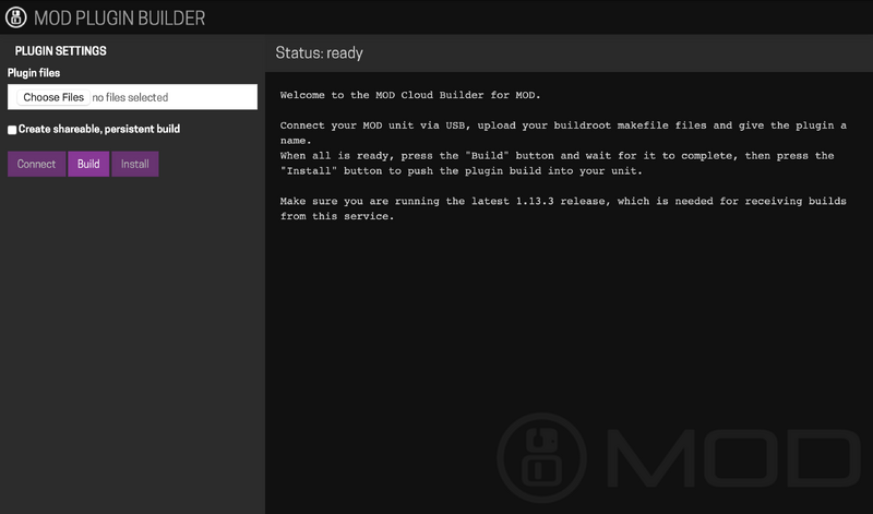

Build from a makefile (.mk)
To build directly from a makefile, you should use the buildroot page from the online MOD Plugin Builder: http://builder.mod.audio/buildroot
With that page opened, you should:
  1. start by connecting your MOD device to the same computer (make sure that your device runs at least the 1.13 version of the MOD OS);
  2. Upload your .mk files on the left of the screen;
    1. If you wish to create a persistent shareable link for your plugins, so you can share it with other users, check the box for that;
  3. Click on "Build"
If everything is correct with your files, a build of your plugin will be made for each of the MOD devices (MOD Dwarf, MOD Duo X and MOD Duo).
You can then click on "Install" and install it on the MOD device that you have connected. Alternatively, you can share the link that was opened if you had the "Create shareable, persistent link" option checked.

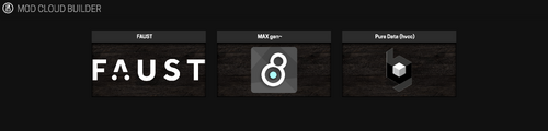

Build a Pure Data, Max Gen~ or Faust based plugin
If you developed your plugin using Pure Data, Max Gen~, or Faust and want to build it and install it in your MOD device, you should head up to http://builder.mod.audio/
There, you will see a first window to define which of the three is your plugin based on.
  1. Click on the correct option for what your plugin is based on;

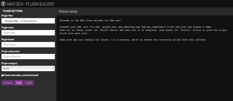

  2. A new window will show up where you should load your plugin file and input some metadata regarding your plugin (name, brand, plugin category, etc.)
Note: Although this is a screenshot of the MaxGen~ based plugins page, all the others have similar pages.
  1. Click on "Build"
