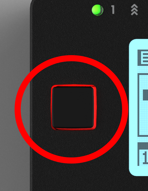

Menu button
The Menu button is located on the left side of the display.
You can edit the Menu Items controllable from this menu in the Menu Items settings.
