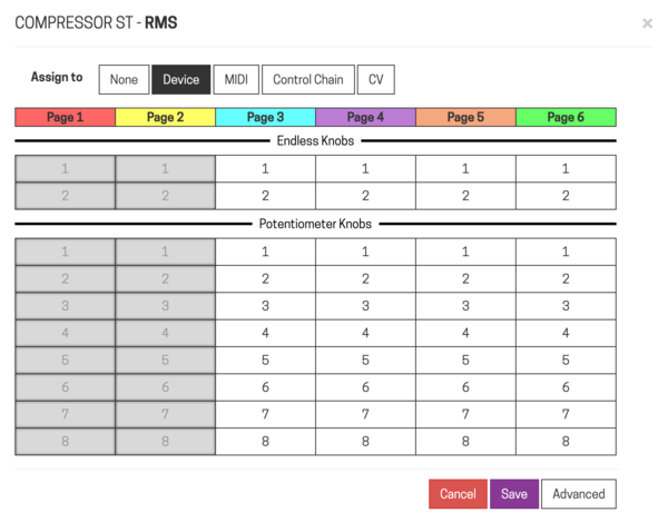

Switching pages
Note: The animation above does not show it in detail, but Buttons and Endless knobs are also paginated.
The MOD Duo X includes a pagination system that gives you access to 6 pages of assignments. This means that the 8 knobs, 2 endless knobs and 4 buttons are actually 48 knobs, 12 endless knobs and 24 buttons.
From the 3 performance buttons on the MOD Duo X, you can set if you use 1 to switch between pages and 2 for Instant Snapshots, or 2 to switch pages and 1 for the Instant Snapshots.
You should define the mode that better suits your workflow in the Device Settings of your device.
1 Button
In this mode, only the central button will swap between pages, and therefore, you don't have immediate access to a particular page.
Yet, in exchange, you have access to 2 Instant Snapshots, 1 saved and accessible using the left-most performance button and another saved and accessible from the right-most performance button.
To change the page, simply press the button.
2 Button
In this mode, the left-most and the right-most performance buttons are used to scroll the pages. As expected, the left-most button will move down the list of pages and the right-most button will move up the list of pages.
In this mode, you have access only to one Instant Snapshot (from the central performance button).
According to the page mode that you have selected, the buttons to swap the pages will light up with colors that indicate the current page:
