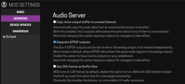

SPDIF out
The S/PDIF output on the MOD Duo X is a digital output that can be used either to mirror the two audio outputs or to have two extra digital outputs. You can connect it to your audio interface or to any device with a Digital (S/PDIF) input.
Please note that the S/PDIF port is only an output port; therefore, you can use it to input audio into the MOD Duo X.
Note: to use it as two extra outputs, you should access the Advanced Settings of the WebGUI with the MOD Duo X connected to your computer or mobile device and activate that function.

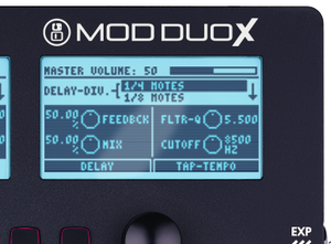

The MOD Duo X has two large (2.8") LCD displays. The displays normally give dynamic information about the actions mapped to the device actuators, but they are also used for displaying the device menu and tuner.
You can define the display contrast for each particular display on the Device Settings.
Each part of the display corresponds to one of the actuators. (See the image on the right)
How each section of the screen maps to each actuator
Left Display
The top section of the left display shows the Current Pedalboard name.
The section just below shows the control mapped to the left endless knob.
The four following sections represent the four most the left knobs of the MOD DUO X.
The bottom section represents the two most left buttons. Notice that the background color changes to identify the parameter status.
Right Display
The top section of the right display shows the Master Volume. The Master Volume can be adjusted by pressing and holding the right endless knob. See more information in the Adjusting Volumes section.
The rest of the sections represent each actuator in the same way as in the left display, but mapping to the knobs and button on the right.
