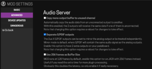

===SPDIF out=== | ===SPDIF out=== | ||
| − | The S/PDIF output on the MOD Duo X is a digital output that | + | The S/PDIF output on the MOD Duo X is a digital output that can be used either to mirror the two audio outputs or to have two extra digital outputs. You can connect it to your audio interface. |
| + | '''Note''': to use it as two extra outputs, you should access the Advanced Settings of the WebGUI with the MOD Duo X connected to your computer or mobile device and activate that function. | ||
| + | [[File:SPDIF Settings MDX.png|thumb]] | ||

SPDIF out
Note: to use it as two extra outputs, you should access the Advanced Settings of the WebGUI with the MOD Duo X connected to your computer or mobile device and activate that function.
